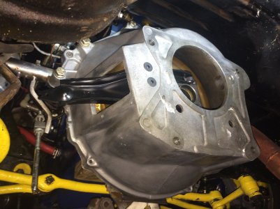

That's correct. He will just need to make/drill to 2 upper holes to fit the block. It was a tight fit/on edge so I added inserts and ran a 1/4-20 bolt on the upper 2 bolts.

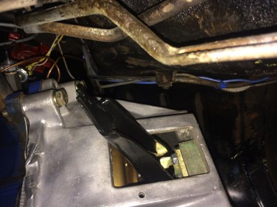

the 157 T FW was used with earlier 302 blocks and with the typical 80's Mustang T5 Bellhouse. Early 157T (Toploader) BH's all used PUSH linkage with 'Throw Out' arms. Late 70's / 80's used CABLE PULL Throw Out setup. Cable PULL throw out can be simply converted to original early car PUSH linkage.
80's Mustang SBF T5 157T BH / Cable to Push fulcrum with cable mount sawed off (E3ZR) :
