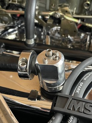

That’s a very nice piece! And you are right, a bit pricey lol
If the one I’ve ordered is not gonna work out, this will be my next step, thanks for the link!

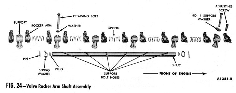

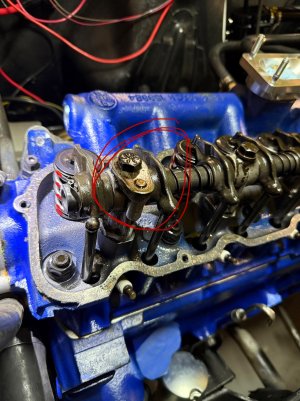

That part is the oil return outlet for the rocker assembly.
But is it essential? The adjustable rocker assembly I got doesn’t have it, but I can swap it from my non adjustable assembly. Just wondering if I need to have it. In ford manual, it does show the oil return stand on the diagram.
I can't say for sure, '60-'62 and '63 supplement factory Falcon manuals show the drain back. My running '63 170 adjustable, and spare '65 200 head with adjustable both have it, but my on stand '70 200 non-adjustable does not.
Your non-adjustable set up does have it. What year is your head? Ford must have eliminated it at some point.
In theory, I think it would just increase over all rocker assembly oil pressure without it.
My head and block are ‘66, this adjustable I picked up is from 170 engine, not sure of the year.
Could it be too much oil pressure in the arm? Also, I’m thinking maybe that’s why I didn’t have too much oil splatter from my rocker arm, when I ran it without valve cover - not much oil pressure. Also, I didn’t see much oil coming out of the valve side.
Do we know where the oil flow goes after it leaves the rocker shaft? Back to the pan or does it feed something else?
It’s just drains to the valve/pushrods area around 1st cylinder and goes down in pushrods shafts, that’s from my observation while running without valve cover
Just to be clear, are you talking about the loose oil splashing around the under the valve cover or the oil that exits the rocker arm shaft thru the stand on the opposite end that it enters? ( thru a stand )
It seems to me there would have to have some kind of restriction to keep oil pressure, like feed another part of the engine. Or maybe the rocker shaft is the end of line and doesn’t go anywhere else?
I am not familiar with the lubercation flow on 200🥹
A faint memory bell is going off. Something about a rocker arm bolt having a flat spot for oiling or maybe a reduced dia. shank.
Rocker assembly bolts all have a secondary step down on the shank. Maybe you are thinking about the single head bolt that is stepped or flat for oil supply to the head, driver's side rear bolt.
Yep that sounds like what I was trying to remember. Would the wrong head bolt mess up the oil flow to the rocker assembly.
