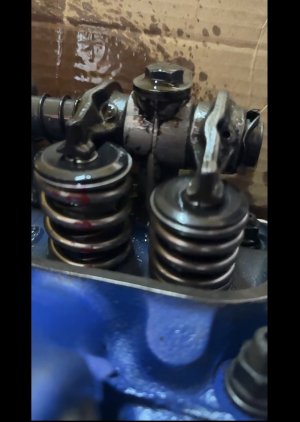

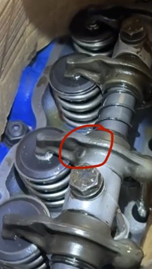

Shoot, I forgot to check if the pushrods are turning. Is they are not, what would that mean?You have plenty of oil flowing down the pushrod, I cannot see if they are turning. Oil should be a low dribble out of the valve side rocker hole and following the rocker and dripping on the tip of rocker and valve. Your idle is so low you may not have enough pressure. What is the oil pressure as videoed? I would like to see more oil on the valve side of rocker, that is what cools the valve. Maybe it is fine at driving speed? Did you modify the shaft or rockers?
Hm, okay, I’ll check that again with push rods. Good thing that DON once suggested to get a reusable silicone gasketIf the pushrods are not turning that usually means that the lifter is not turning and the cam will fail, those parts have to rotate to wear evenly. Tell me something is that video slowed down, I do not think an engine would run that slow? Yes at cruising speed there would be more pressure and flow plus oil gets knocked everywhere.
