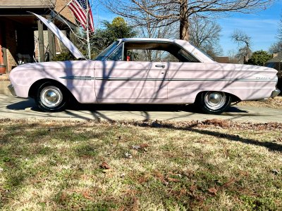

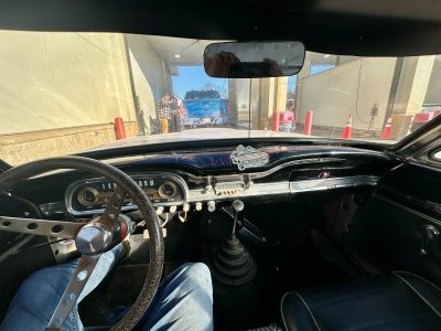

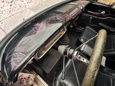

I recently bought this Falcon on a whim and I am trying to figure out what to do with it. It runs and drives, but there are clearly some timing and shifting issues.
Here's what I know. It's pink. It's awesome. It's straight and solid.

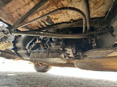

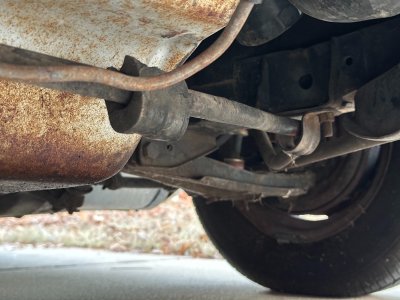

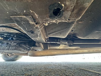

Here's what I don't know. What the heck the drivetrain is made of. I know that the owner blew up the original motor beyond repair (windows install) and had a shop put a motor/trans in it. He was told it was a 200/3 speed auto that was installed.
It was originally a 2 speed auto. Now it's what I think is a 5 bolt case fill C4.

I'd replace that bodged together lower radiator hose right away, looks like a piece of flex exhaust pipe.

Sweet looking ride! That is cool. Yes to everything @frozenrabbit said. I didn’t notice the pertronix wiring until after reading his post. Good eye.

Cool car!
