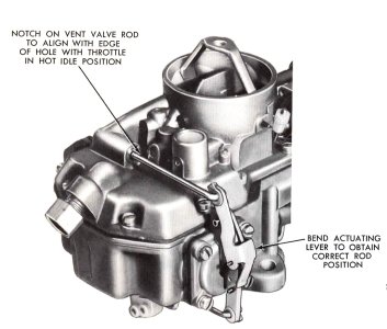

Your carb is missing the bowl vent rod and linkage arm for it.
Don't know if other forum members can see your video uploads.
