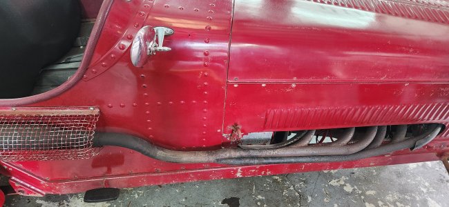

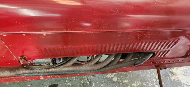

WOW ! very well done personal art form on wheels with such attention to Alfa visual details . I'd like to know more about the builder and your passing it to the future.

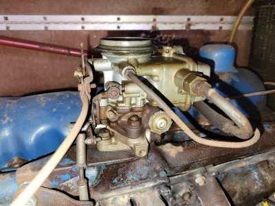

The carb is a small, manual choke Holley.

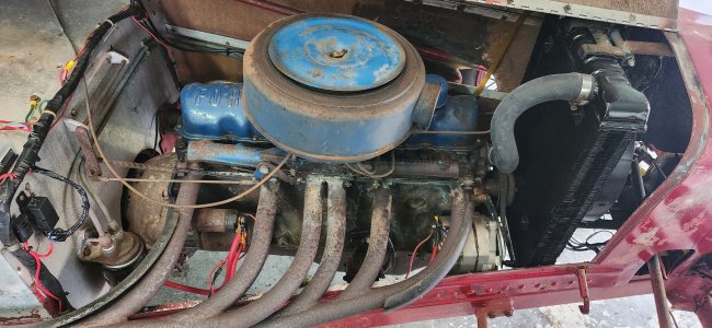

Custom header sure looks authentic! There are valve cover varieties that don't say Ford on them to help with the illusion. How's the oil pressure? Those are some long not very big diameter lines to that remote filter. And I like the way the jousting spear, I mean the steering column, runs right through the engine compartment and hood to get to the front end.
Could definitely use a valve cover gasket, and get rid of the flat head valve cover screws. It's gonna have umbrella style valve seals. A lot of oil on the head, but that oil pan looks very dry.

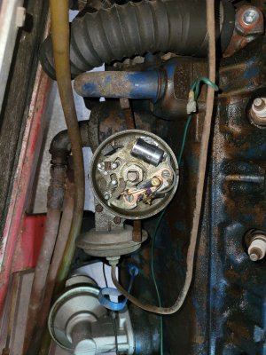

Most likely that is a SCV carb and LOM distributor. If this 170 is weak, you can certainly swap in a 200 and keep the trans set-up. Better distributor options. Would mostly be a bolt in swap. 200's are easy to find, and cheap, hard to give away a 144 or 170.
The gauge says the oil pressure is good. Good point about the oil lines. Yeah, not a lot of safety features on this car.

I wasn’t there to drive it but the inspector did. With the manual choke, it’s a bit touchy getting it started. The inspector said the idle is set too high, which probably means it won’t stay running unless it is. The carb shows corrosion and I’ll either get a rebuild or replace it. I’ll also make sure the distributor is up to snuff. Once started, the inspector said it ran well and accelerated smoothly. The money has changed hands so I’m committed at this point.

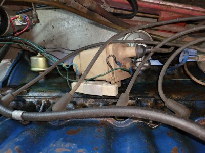

The engine seems to be fitted with the original carb and distributor. The carb is a Holley with a Ford tag. The distributor looks to be a load-o-matic, with a weird aftermarket coil - presumably high voltage. The carb should have a spark control valve but there's a device in the SCV opening that doesn't look like any spark control valve I can find online. I'm thinking I'd like to replace the distributor with a DUI but get the carb rebuilt and keep it, if it can be made to work with the new distributor.

sure is fun looking at that One-Off unique car built with a personal attention to the details to make it a Walter Mitty' surreal Alfa or Bugatti or similar ...
especially like the original Falcon bellcrank accel pedal , smoky road tube , remote oil filter with NPT fittings at block , square body coil , ubiquitous Holley 1904 carburetor - ( accepts glass fuel bowls for visuals ).

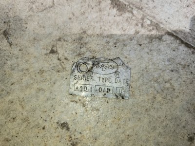

In post #30, there is a question raised about whether the cylinder head is for a 170 or a 144. Now that I've got the car, I can see that the full cylinder head number is C0DE-6090-C. Since the head has had a couple of revisions since the original, would this make it appropriate for a 170 despite the "0" code? Also, do the year codes apply to when the part was cast, or to the model year of the car it was made for?
I can shed some light on that but not all. That casting code is more like a design or blue print code that tells what the part is and what model year when it was designed not when it was made but how it is made. You will not find a C8=68 in a C0 car unless it came from a C8 but , you can let us say, you can find a C8 170 block in a 72, because Ford did not change the design from 68 to the end of production. There can be revisions, that is the last letter. I am sure other members can add more.
Thanks. No other responses, so I guess you nailed it. I'd like to think the engine is unchanged from original and leave it like it is for posterity, but I don't like the thought that the head might have been changed and now the valves are undersized.
