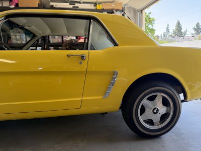

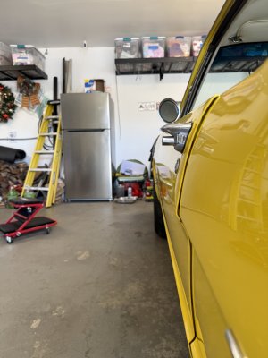

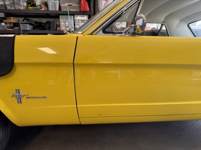

@Otto I ended up getting S-style wrenches to get to the bolts on the frame. Gosh that was pain in the ass to adjust those doors....Lined them up okay, but when I installed the striker, the door wouldn't completely go flush with the back fender (without striker it was nicely lined up). I think I need to move front part a bit outward to make the back part move in more. But I'm afraid that then I'll catch front fender. Another option I see is to elongate the holes for striker bolts, so I can push it more towards "inside" the car.
Glad you were able to obtain the hinge wrenches, that makes it a lot easier.
Just a thought on your comment about getting the door to shut tighter- if you've brought the striker in all the way and the door is still "out", is it on the second click of the latch or the first? I have seen doors that won't fit flush to the 1/4 panel with the striker adjusted as far "in" as possible, but only catching on the first click. Adjusting the striker outward took care of it.
It's hard to tell, but the front of the door might be a bit low. Gap at the back looks good, Mustangs usually have tight lines. The door/fender alignment should be flush or the fender out slightly to avoid wind noise.
Thank you for the tip about second click on the door lock - that actually made a huge difference and the door sits almost flush in the back now.
That door aligning situation was a one man show for me, so for now I’ll leave it as is. But you are right, it can sit higher. Just couldn’t get it up more by myself. I’ll come back to it.

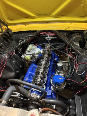

So I put everything back together in the engine (new adjustable rocker arm assembly and new replacement carb from Redline Weber). Adjusted rockers to zero lash plus 3/4 of a turn.
Carb was set up to idle screws 1.5 turns out with following jets per Redline:
Mains 145
Air corrects 170
Idle 55
E/t F50
70 double pump
Was trying to start the car yesterday and completely failed - at the beginning it was trying to start, but at the end of the day just didn't want to start. I think I ended up flooding the engine.
Decided to check the compression with new rockers. Removed all spark plugs and when I was checking compression on the first cylinder, cylinder #6 just spat up a bunch of gas from spark plug hole lol. So yeah, flooded....
Compression was good:
1st - 175
2nd - 170
3rd - 165
4th - 170
5th - 160
6th - 170
So I assume that kinda scratched possible problem with valve adjustments?
Checked the battery - was at 49% charged, so got it charged overnight.
Was trying to start it again today (after letting it air out some of the gas from the engine). It started briefly, but kept dying on me - had to hold acceleration to keep it running. Eventually it died again (when I let it go). After that, wouldn't start again.
Car ran before with faulty carb (dumping too mush fuel) and regular rocker arm.
Spark plugs are fairly fresh (maybe 40-50 miles on them).
Ignition was roughly set to 8-10 degrees advance.
Distributor gets power and I removed spark plug wire and checked that there is spark while cranking.
I'm a out of possible options what to check/do now. Not a fuel delivery problem, as it definitely gets gas in.
My options are: my DUI distributor is not giving full spark (Dyno Module?) or try to put back my non adjustable rocker arm assembly and try starting it again. Maybe I did mess up something with the valve adjustments....
Anyway, any suggestion or direction to move forward would be greatly appreciated!

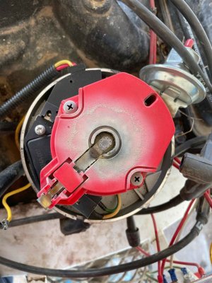

Added:
Read back some and your engine has good compression. You mentioned that the engine ran briefly. Can you roughly pinpoint how long in seconds? I understand that you know that Redline/Weber recommends 2.5 to 3 lbs. max. Just make sure you are not over 3 psi. (Preferably slightly below 3 psi. If you’re using a mechanical fuel pump that momentarily pulsates over 3 psi. I would recommend an electric fuel pump that gives a nice consistent pressure.
Below is a simple troubleshooting guide that I quickly put together. It should help you trying to figure out what could possibly be wrong so hopefully your able to pinpoint and correct the problem.
Note:
In the order written below, please follow through steps 1 through 5 in the order exactly as written. (Do not skip any steps)

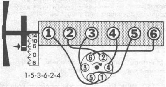

1. Are the plugs are gapped properly and all have a good spark? Take note and go to step 2
2. Is the Spark Plug firing order is correct? (See picture below) Take note and go to step 3
3. Is the distributor is 180 degrees out? Take note and go to step 4
4. Is the distributor is phased correctly? Take note and go to step 5
5. Check initial Ignition timing with a timing light. If everything is correct, the engine should fire up if it’s getting fuel.
Note:

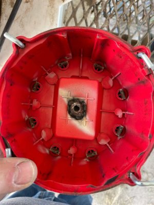

If the engine doesn’t fire up, there is a good possibility that there is something wrong with the DUI distributor. Check the coil, module, magnetic pickup, distributor shaft for excessive side play and reluctor air gap. Then proceed to the next sentence below.
I’m not a 100% sure, I think some HEI caps use carbon tracing to make contact from ignition coil to rotor. I think some rotors also use carbon tracing to the rotor end. Please check them out.
The pictures below are extreme examples:
Added:
If your spark plug cables are carbon core, it would be a good idea to consider switching to wire wound spark plug cables. High resistance spark plug cables can cause caps and rotors to burn out quicker.
Hey @63 Sprint , thank you for the guidelines - I'll check it all after I get to change the oil - don't want to crank the engine anymore with gas in oil.
I do want to say, that the car was running with current parts (spark plugs, dizzy). The only thing that was changed/updated - adjustable rocker arm and replacement carb (Weber 38/38).
I did have a problem before, that I put dizzy 180 off - but it was backfiring in the intake. With my recent attempts to start - it started couple times, but didn't stay running.
The dizzy looks good, nothing looks burnt or anything similar. I have LiveWires coming from it. Spark plug gap is set to .050"
I do wanna ask you about checking the spark - I assume I should check all cylinders? I did check #1 cyl by pulling the wire off the plug and cranking with ignition on - had a spark there. Should I check the spark with actual spark plug connected to the wire - to make sure that spark plugs are okay?
And then I do have a spare Dyna Module, that I can swap and see if that changes anything.

Willingnesslimp,
What might help you getting the engine started is if you have use of an air compressor, pull all plugs and blow air in the spark plug holes to evaporate the fuel. Caution, please do this outdoors. Blow off the Spark plugs while you’re at it.
Weber carb’s are very sensitive to fuel pressure. I see your running a mechanical fuel pump. The reason why I’m bringing this up is pulsating mechanical fuel pumps can cause flooding issues even if pulsating pressure is at, or slightly over 3 psi. In simple terms you might have fuel hammering going on. In industrial, commercial and even residential plumbing, a shock arrester needs to be used at times to eliminate hammering. This is one reason why I personally do not like mechanical pumps on carburetors that are sensitive to fuel pressure. I got away from mechanical fuel pumps years ago.
You need to see more than simple spark, It should jump 5/16-3/8 of an inch. nice and blue. Check it for several revolutions- 5+ There have been times I have seen a good initial spark and then it would deteriorate. BE CAUTIOUS OF BUILT-UP UNDERHOOD GAS FUMES. Have a heavy blanket handy to throw onto an unexpected flame-up. Some moving blankets are fire retardant.
Not moving up and down? I will definitely need to recheck them all…sometimes I wish I had someone to show me certain things and not go through trial and error
I'm sure you are rotating the engine to be sure the lifter is on the base of the cam?
Willingnesslimp,
I just noticed that you are running a regulator with a pressure gauge before the carburetor. The way it looks is it’s plumbed as a dead head system (without a return line). Such a system will not work with your Weber carburetor that has a mechanical fuel pump.
My recommendation is start with a facet electric fuel pump and keep the regulator as it is.
Here is a fuel pump that should work deadhead with your regulator.
If that doesn’t work, then I would recommend replacing the regulator with one that will allow a return to the tank.
