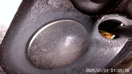

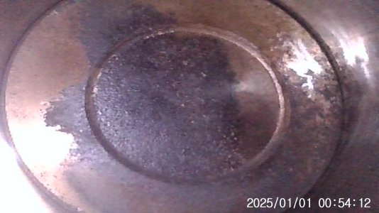

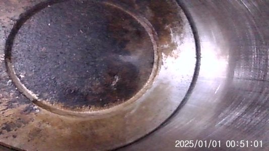

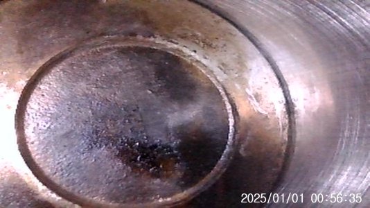

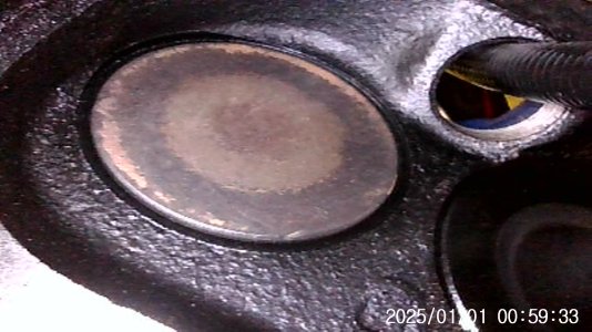

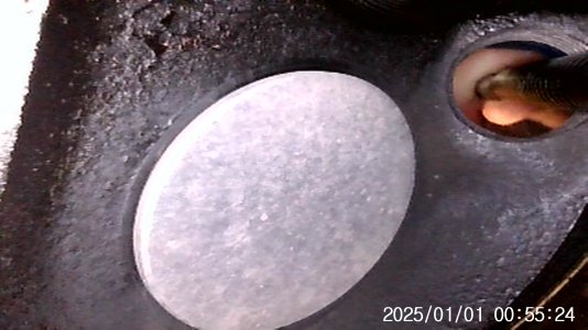

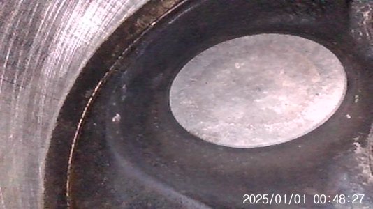

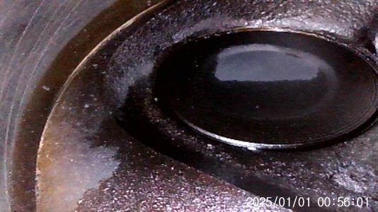

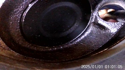

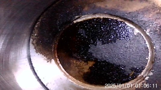

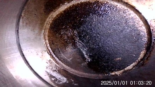

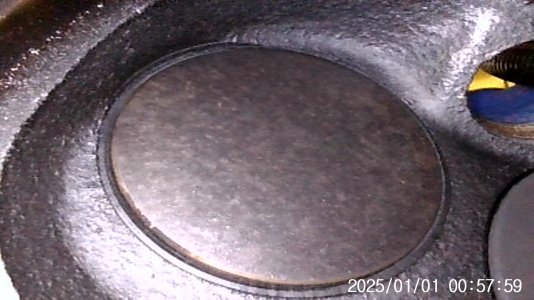

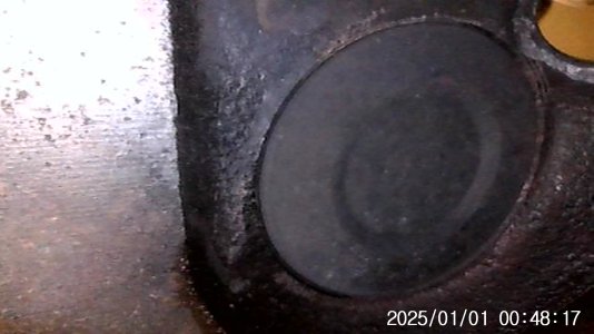

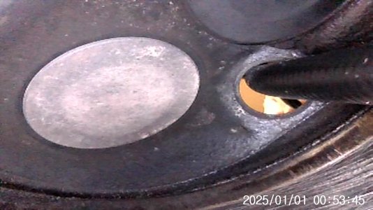

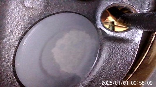

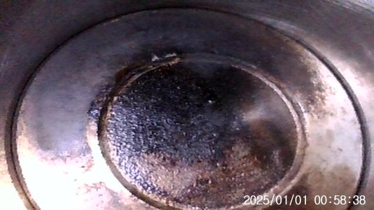

Took some pictures of the internals tonight.
Does everything look okay or would be any concerns?
The one of concern was cylinder 1 and engine only had about 20-30 miles on it, half of which it was running retarded
Ordered all parts, as get to it to assemble and check everything, I'll post an update.

Good pics! I can never get those scope cameras to do what I'm trying to do. . .
Some intake valves show oily, it could indicate poor oil control in the valve guides. Pistons are pretty carboned up- The engine is too fresh to judge oil control yet, so not assuming premature conclusions. Looks ok for not broken in IMO. There's no physical damage, that's the main thing at this point!
I find it odd that there is so much difference in carbon build up and burn off🤔
Maybe just from not being broke in yet?
The cap on the front of the valve cover should be vented, is it?
Look to see if the valve seals look ok. What style did you use?
Yeah, I didn’t expect to see so much build up for such a short running period…
It looks like in cylinder 3 the valve is oily, you are right.
I think I’m gonna steer away right now from pulling the head off. Will fix the rocker arm, check that oil gets everywhere in the rocker arms and run it like this for a little. After maybe 100-200 miles will look with the scope again and see if there are any changes inside.
The only thing that I didn’t do (and kinda regret it) - check the valves for leakage when I got the head from the shop.
@drag-200stang yes, cap is vented and PCV goes into oil catch can and then in a port under carb (I tapped into carb adapter). As for the seals, machine shop used umbrella style.

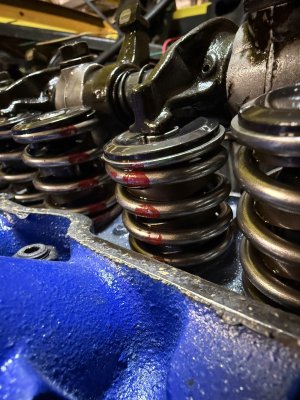

Here is a picture of the spring under load, I don’t think coil bind was the case - still a lot to go
If you've hydraulic lifters you can't get a measure of the open valve lift, the internals of the lifter are squeezed down to bottom by the force of the valve spring.
Coil bind is not a factor, ample space there for more lift.
