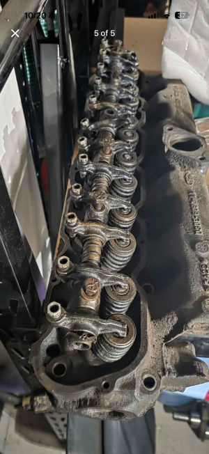

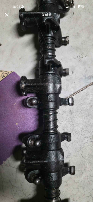

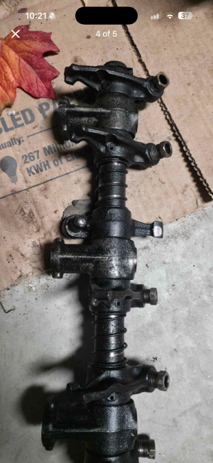

Side questions, does this adjustable rocker arm looks like worth $100 and shipping (probably about $140 total)

You can buy new adjusters. Which I would recommend, sometimes they turn too easy because of wear causing adjustment problems. Shafts can be replaced too. You just have to watch out for wear on the valve ends. The picture of the one doesn’t look bad but they don’t necessarily wear evenly. I would assume the pads are hardened so just machining them smooth again might not be a good option. If you put them on an occasional driver you would probably be ok, but the more miles you put on it the bigger risk you are taking
Does it come with pushrods? The adjustable rockers use a ball and cup pushrod and won't work with the regular ones. I think it might be a good idea to grab that set and rebuild it as necessary. It will give you the ability to dial in the valve lash more effectively than the fixed rocker arms and that might be a good thing since todays head gaskets are much thicker than the ones these engines shipped with. Also, if you do decide to shave the head to bump up compression, you'll need the ability to adjust the valve-lash in the other direction.
Rockerarms unlimited in Redding, CA will rebuild it.

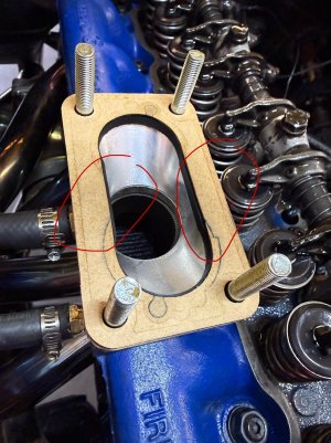

Also, I’m still concerned about my carb. I feel like it’s leaking gas a lot. I put new gaskets and they started to soak up gas from the carb. I did put fuel gauge before the carb and it showed 3 psi, which is good for Weber 38/38.
It was a new carb, but maybe I fiddled with it too much and need to completely readjust it (maybe bring somewhere, I feel like I’m starting to fuck things up).

I'm sure you haven't put the carb too far out of spec. They're pretty forgiving and even if you got your idle mixtures all messed up, when you give it throttle, it's off the idle circuit and should be able to run off the mains anywhere from 1200 and up.

It's ok for the gaskets to absorb fuel but they shouldn't be leaking at all. Make sure that the base of the carb is true. I can't imagine how it could happen on yours but I have seen old carbs that were torqued down incorrectly and they warped the base.
Just had a thought: The phenolic spacer I have was just ever so slightly out of registration for the mounting holes so it was too tight on the carb studs and I was worried that it would bind or cause a vacuum leak. I drilled all 4 holes out about 1/32" larger than the existing holes and it dropped on perfectly. If yours binds, it is probably the cause of the vacuum leak.
