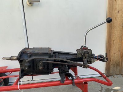

Here’s what I pulled out. I think this might weigh more than the 5-speed I’m replacing it with.
Hey, fun fact I found out this afternoon: If you have a Top Loader 3.03, then you don’t need to upgrade the clutch in order to mate the T5 to it. You could in fact, just remove the Top Loader, bolt an adapter plate on the bell housing and bolt in the T5.
I’m not sure what mods you’d need to make to the transmission mount to accept the T5 mount and I’m not sure if the slip joint needs to be changed. I’ll check the slip joint tomorrow but that would make swapping from 3-speed to 5-speed on cars with the 3.03 even easier.
