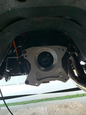

Oh, hey… I checked and the OEM Slip Yoke on my drive shaft is the same teeth as the T5. I already swapped mine over but I may need to swap it back because it is several inches shorter than the OEM slip yoke.

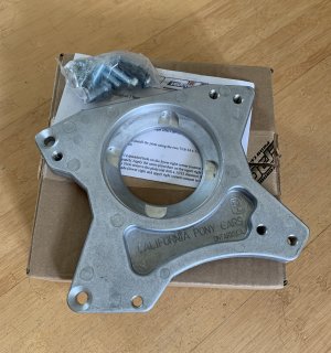

With this in mind, in essence for someone with a 66 Mustang, inline 6 200, with a 3.03 Top Loader, the only parts that they really need to buy or fabricate are the adapter plate for the bell housing and I think the transmission is deeper at the cross member, mounting point so they will in all likelihood need the upgrade cross member.
They will need the appropriate pilot bearing too but they could used the OEM 3-finger clutch and leave everything else alone. I’ve done plenty of engine transmission swaps and this is by far the simplest one (now that I know the ropes).
Still waiting on the correct part from CPC.
