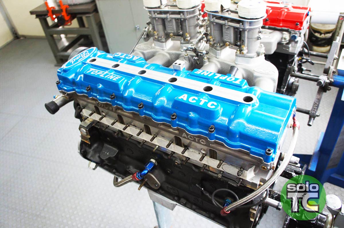

Normally when you dry sump and engine you don't use the origin oil filter housing, its blocked off because the internal oil pump isn't used, therefore the galleries running directly to it would be redundant.what's with the two oil feeds to the rear and middle of block- for crank mains ? or cam bearings ?

By pass oil filter, oil comes out from original oil pressure opening, goes through the filter, then is returned to the sump through the unused fuel pump housing. The valves shown might be to control the pressure loss that would otherwise occur doing this.Normally when you dry sump and engine you don't use the origin oil filter housing, its blocked off because the internal oil pump isn't used, therefore the galleries running directly to it would be redundant.
I would say that the aluminum filter housing blocks to old filter boss and oil is fed in and out the aluminum housing via those external lines. if you look at the left of the new housing you can see a screw in pressure relief valve.
