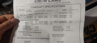

I'll do yoy one better and include the cam card. Its 2800-6000rpm range. This is a rompy cam. Its a Crow 14650 cam. This is just what came with the motor (not installed).

StarDiero75, the cam you have is a Crow Cam 14650.
Attached is the cam specs.

Your cam is on the small side for 450fwhp unless you are jamming in some boost.
