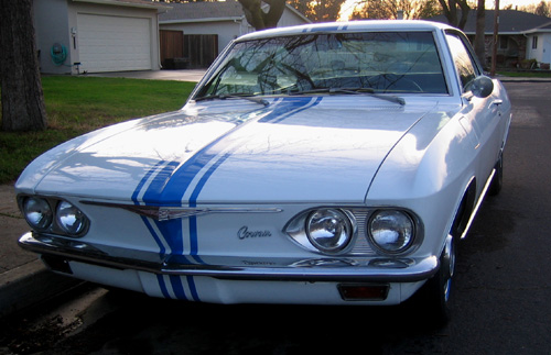

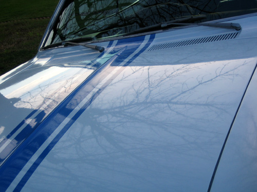

Pics of the Corvair's roll-on Rustoleum paint job after 4 months on the street, in the sun, rain, and getting crapped upon daily by birds. I washed the leaves, dirt, and scrubbed bird poop off this morning, drove it around most of the day, took some paint pics when I got home this evening.
I can't tell -any- difference between the paint's gloss today and 4 months ago. I still haven't gotten around to waxing it.
