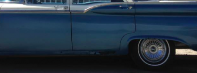

attached is a screenshot of some rust,,, is there any significance repair wise to the part under the rear door. it looks sorta bad,, or is it more likely a pre cursor to more hidden stuff,

The Rockers (Under the doors) consist of the outer panel that shows in your picture and an inner panel togeather with the bottom of the door sill's forms a strong box like structure, plus there are some body support braces these are mostly all below cars floor sheet metal. The first two you can easily see the signs of rust damage from the top the latter two you will need to either go under the car to see from the back side or use a mirror to see with. Most times this type damage can depend on the local area condistions the car is used in and in some part how the car was constructed. In my experance on these Fords the rockers can get dirt inside and then rust out the outer rocker panel from moisture being trapped inside. The last one I was doing (that had quite semular looking damage) this was a while back was on my 1954 Ford Customline Fordor Sedan that's in my signature. Again without an actual in person examination of this particular car, but as an example the cars I have repaired over the years usally only need the outer panel replaced or a partial section of the outer rocker panel patch welded in and a good cleaning & some rust incapulation plus paint protection. That said there are many cars with this type damage driving around that aren't even repaired its usally just a cosmetic's issue rather than structural. Personally I wouldn't go through all the work of doing one of my paint jobs without doing those type repairs first.
The cost of these outer rocker patch panels and other body patch panels is very reasonable (see below link for example of the outer Rocker patch panel) on a small section i make a repair panel or find a section that can fit in the local junkyards. However I can't say how much the labor cost is to do the job of cutting out the rust damage, welding in the new metal patch panels, and then painting the repaired sections to match in your area of the country or if you have the skills and plan to do this repair yourself. While your inspecting the inner rocker area and the braces from underneath be sure to examine the cars floor sheet metal and lift up the trunk carpet or mat to check the floor too. I don't think I have ever worked on any Montana area cars or trucks to know what you'd expect to see however my first car that I bought was in North Dakota (was a 1928 Model A Ford) it had also had a partial restoration and was repainted were it looked fairly decent, it also had a few rust issues that I needed to repair while doing a compleate disassemblely for a full restoration of the car back in the mid 1960's. I took this car and competed in the Model a Restorers Club car shows and driving skill & touring events as well as some other small car shows. I have been doing body work and paint since I was 13 learning those skills on that first Model A, for me these type repairs are fairly quick and easy to do so they don't faze me. If you can't do the work required then you should try to get some kind of a body shop estaminet so you know what the actual costs would be this may also help you in the negotiations on the cars price too though the asking price seems quite fair to me compared to the cars in my area. Hope that is of some help to you best of luck. :nod: Edited Due to a Lighining Strike Here.

thanks for all the detail. I have nowhere near that experience or tools to do body work,,, he had it sort of heavily over coated, and you could see the old paint under neath flaking. like it needed t be scraped, on a house,, you can see the old layer,, i am a bit leary of it,, it rode good, needed a solenoid rebuilt to use the over drive. probe;y pass, but again, thanks for al the valuable information,,
For sure it needs the old damaged sheet metal cut out and replaced but these cars have strong full frames supporting the body it's not like new cars were it would weaken the structure. You could always have a body shop do the repairs or there are even school students at collages or tech schools in some areas that will work on them just for the experience its somthing that can be repaired without having the car down for a long period of time.
