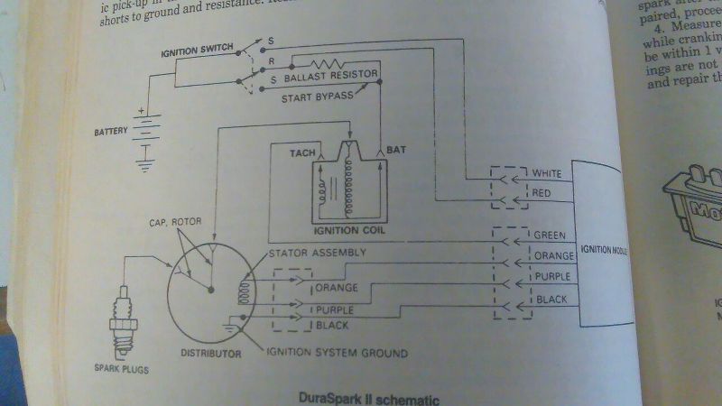

First question, is there a simple diagram or instructions to splice in the duraspark box into the existing harness?
