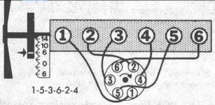

Saying that the cap, rotor and wires being all new tempts me to say that the plug wires may be on the wrong cap terminals. The distributor rotates clockwise on the sixes so if you're used to working on the V8s, it's easy to get the wires wrong.
Thanks all. The coil checks out, none of the work was done prior to issue, firing order is correct. Compression test will be next, appreciate all the input.
