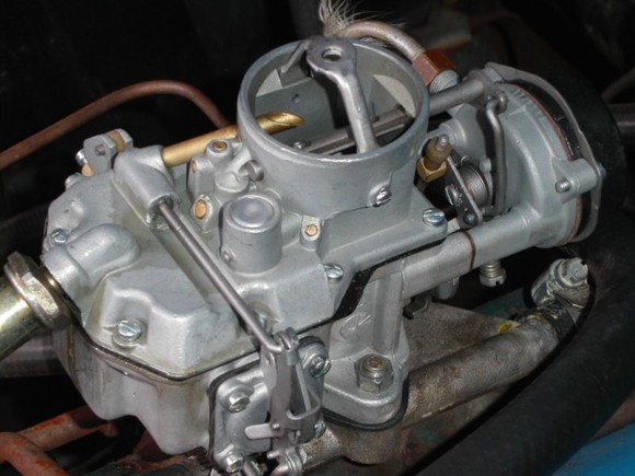

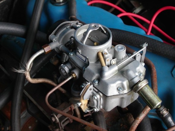

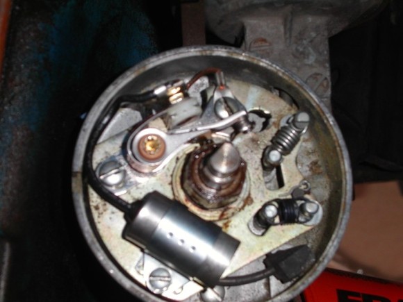

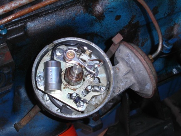

I wanted to create a new post in the hopes of getting all advice or help possible in working to correct the acceleration problems with my 200 Falcon Six.
I'll briefly recap what has been going on with the car:
-Quickly starts and revs to high RPMs with ease in neutral and park.
-However, once put into gear the car has a very difficult time accelerating. Moderate to hard acceleration causes the car to miss, and often stall. With very slow steady acceleration it is possible to gain speed.
-When the engine is cold and the choke is engaged, the car will run fine, however, once the choke kicks down and the car is put into gear the problems begin. I want to make clear, though, that when warm the car will start without an issue and will rev to high RPMs in neutral and park.
-This is the third remanufactured carb I have had put on the car. I have had the car into two different shops and they have not come up with any solutions except that the carb could be the problem. I don't believe that the current carb is the cause of these problems.
-I have pretty much replaced all of the ignition components, (plugs, points, condenser, rotor, distributor cap), except the distributor and coil. I have also replaced the fuel pump and the fuel filter.
-recently it was suggested that I check the vacuum advance on the distributor through a method described by drpepper. According to this simple check, the vacuum advance appears to be functioning without any leaks in the vacuum line.
-it was also suggested that I might possibly have the wrong carb matched to the wrong distributor. I however to not know if this is the case, the distributor on the car is original, and I can attest that my remanufactured carb looks identical to the original carb on the car. It would be very helpful if anyone could tell me how to tell if they are mismatched. If it is helpful, I have posted pictures of both the carb, and the distributor below.
I really do appreciate all the help that anyone has to offer. I do not wish to be an annoyance to this board, but I almost feel that this is my last place to turn to. I haven't been able to find someone or a shop that has been able to diagnose the problem, and what makes matters worse, is that I feel that the solution should be fairly simple.
Thank you for your time and suggestions.
Matt
