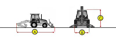

Schematic for Cat 426C
These dimensions are taken from the base model.
Weight 12,000 lbs
English (ft/in/lbs)
