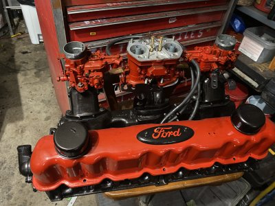

Yep you got to feed it. View attachment 24644
That looks gorgeous. Is that the 'large log' head? What carbs did you put on it?
Also, as far as the high rpms everyone mentioned. Sounds like its just naturally able to handle the high rpm's because of things like solid lifters, short stroke, inline 6 etc... but are there any other modifications he probably made? Balance everything and then.... send it....?
Yeah it’s a large log. Weber 40idf for primary and 34 ict’s progressive secondaries. On vw intake manifolds.

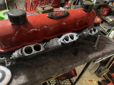

Anybody serious about building an engine for high rpm would almost surely balance everything inside and careful port work also. Source some forged pistons which can come from surprisingly diverse origins. I used Chevy pistons. Forget which (4cyl) engine but wrist pin, deck height matched and a small overbore was done. Perfect fit. IMG_0448.jpeg
