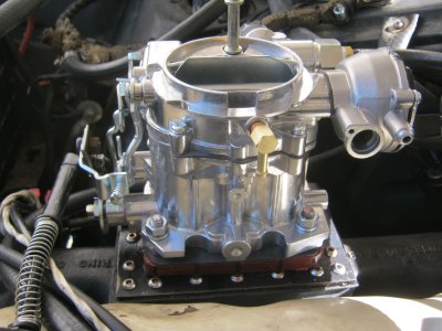

My 78 200 with a greatly enlarged intake bore along with a steel DIY carb adapter runs great with a 500 CFM (V8 rating) large base Rochester Marine type carb. This bigger carb. was a great performance increase over the previous 27O CFM small base Rochester carb. My stock 256 Enginetech cam 200 now easily winds to 5,000 in the higher gears and only drops to 4,000 when I shift. I have 6 forward gears (C4 GV OD) with 3.55 rear gears. I am happier than hell with how my 200 runs with the large base 500 CFM Rochestor marine carb,.
