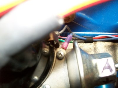

Looking ahead- when you install the new distributor I recommend a dedicated ground be fabricated. Distributors, points or otherwise, ground into the block at the mounting point. I have had them loose ground completely or partially, and it's hard to diagnose what the heck is going on. Might even be your issue now, the symptoms are right.

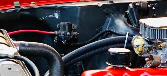

The way, I did mine was by adding the relay just below the starter solenoid that's usually located beside the battery and I picked up all of my connecting points from the solenoid. I took power from the battery junction on the solenoid, inserted a fuse and took that wire to the added relay. I grounded the other side of the relay coil to the chassis and took my relay output to the distributor. I use the same relay to power my electronic choke.
One terminal says S (for start) and one says I (for ignition). I think the one farthest from the battery is the one that says I for ignition.

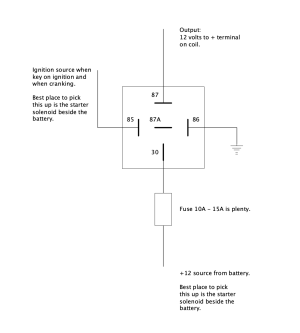

You shouldn't experience a voltage drop if you use your ignition source to trip a relay that will provide 12v to the DUI ignition. Here's a little diagram I made up the other day to show how that works with a standard bosch relay. Bosch relays are pretty common and there are a bunch of knock offs that make the same relay. Make sure that you source 12v from the battery side of the starter solenoid and that you have a fuse between the 12v source and the relay.

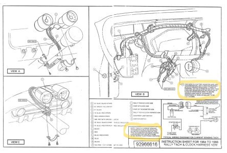

So now I'm wondering if the oem rally pac can be used with the dui since the pac is current sensing not voltage sensing. From the diagram i got online it seems like it might be able to use the tach output from the dui with a ballast resistor to mimic how the resistor wire would work. I looked at another forum and someone mentioned some msd converter box thing. The guy never tried it and just went back to a point ignition instead so idk if that would work

MSD has an adapter for there ignition box. They have a list of tacs that will work without one. I don’t know what it is. Probably cheap if it’s a resistor. It is something you plug into the box.
I do not know the answer to your question. Only hopeful input I have is, the DUI tach-out ran the tach accurately on a previously points fired aftermarket tach, and on the factory tach in a later model truck that had been EFI.
MSD used a choke if I recall correctly. It looked like something you’d find in a tube amplifier. It may have been used as a resistor but I never analyzed the circuit. I had a MSD 6A on my hotrod BMW 2002 a lifetime ago.
The HEI ignition I used has a separate coil and a wire labeled tach. It doesn’t work with my old school tach I have in my Mustang but connecting to the negative side of the coil as one would in the olden days does. I realize the DUI is coil in cap but I wonder if the negative side can be tapped without any modifications. I wonder if the DUI guys can advise.
I use a newer tac with my dui. I would call MSD tec and ask them about the oem tac👍. Or put a newer replacement tac in your pac, same the old one 😎
Edit: call DUI not MSD
It seems to me that must be what the "tach-out" wire on all coil-in-cap HEI's are- the coil negative. That tach feed has worked on every aftermarket tach I've had dating back 50 years to when they expected coil negative only as input. But I don't know this for fact.
So since the tach out is most likely negative all I would have to do it run a wire with a ballast resistor to mimic the pink resistor wire the old ignition uses and it should read properly
