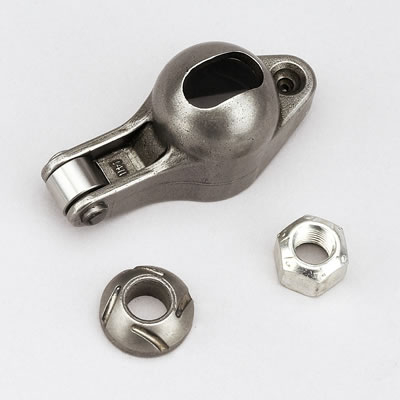

I picked up some 1.72 roller tip rockers for the Crossflow head. They were a steal, so I figured even if they don't work out, I'm not in too deep.
My main concern is that the tips may "walk" off the side of the valve stem and cause problems. As far as I can tell, since they are a ball-pivot design, there is nothing to prevent them from rotating side to side on the fulcrum. With the canted pushrod geometry, I'm even more worried. Is this a valid concern? Should I scrap them and spend the extra $$$ for full roller rockers which won't have this tendency to walk side to side?
