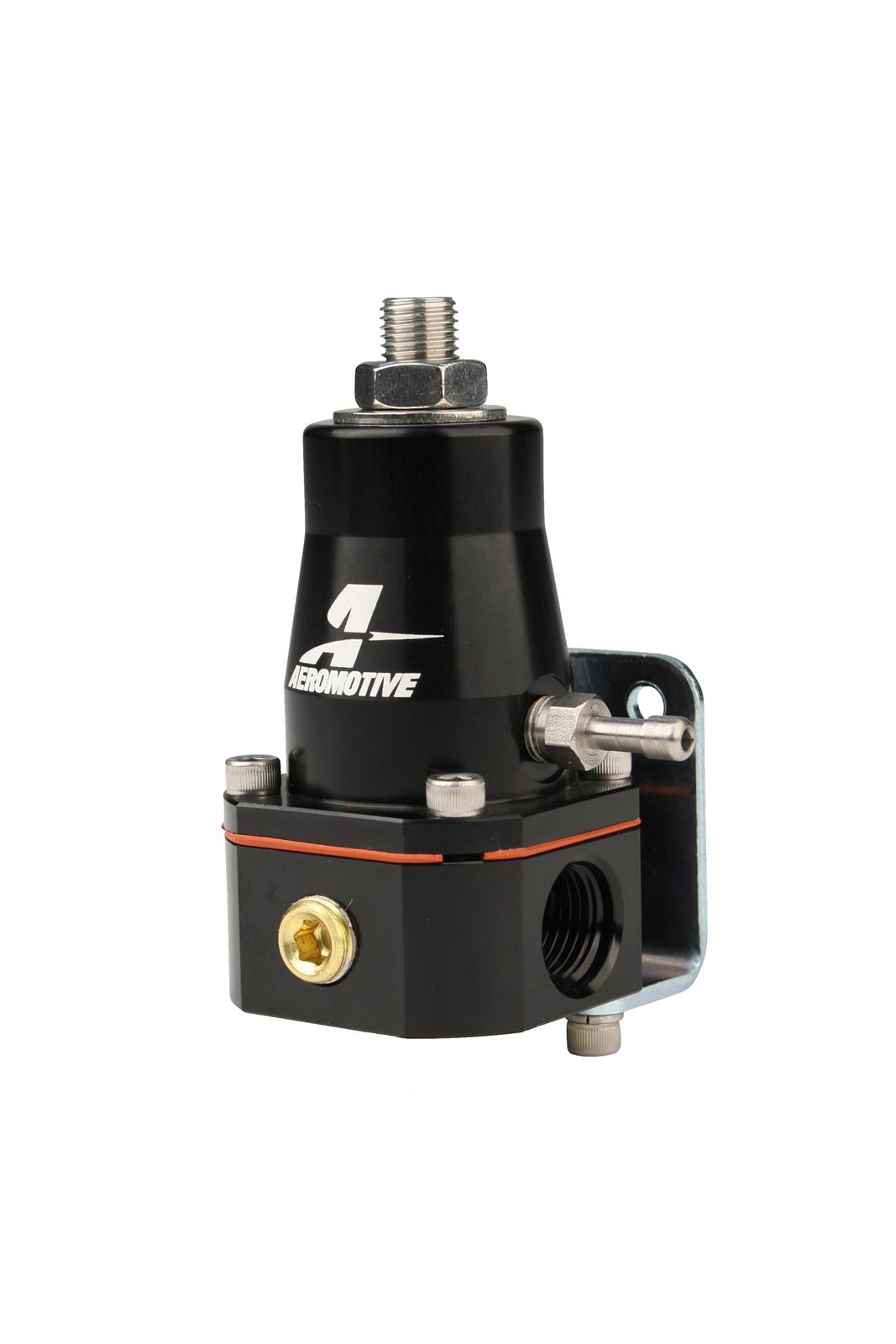

Not suggesting this one directly- but would be a good choice. I've been running an Aeromotive regulator that brings EFI pressure down to carb pressure- a 50 psi drop- untouched for 10 years. They make good products. You're looking for one that has the vacuum reference port. That will be routed to manifold vacuum. High vacuum (low load) = lowered pressure and vice-versa. They have a port for a gauge, it's a good idea. They are adjustable, so with the gauge you can tune in the ideal pressure for the specific EFI in service.
