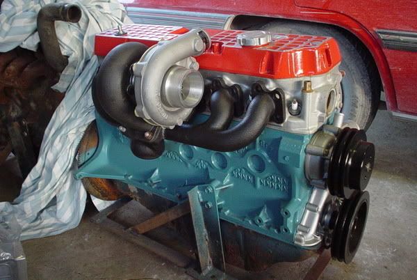

And guess wat, the turbo is back, i dummy fitted it today!!
Struck a couple of minor problems tho, as u do i guess.
1) my cast manifold dont really line up with all the bolt holes to well so looks like ill have to do something about that...its mainly the top holes the bottoms seem ok
2) the front housing on the turbo, one of the bolts just hits the manifold so im going to have to get the front housing moved 180deg and as you will see in the pic anyway, thats definatly not how i wanted the front housing to be but, simple thing to fix, the blokes at the turbo shop are brilliant! (FREE PLUG, MTQ Engine Systems)
As you may notice my turbo now sports a new water cooled centre housing and, a new t4 rear exhaust housing to suit the manifold, (the turbo originally was a oil cooled centre and smaller t3 housing, long storey)
Anyway check out the pics, its slowly getting there!!!!!!!!!!
