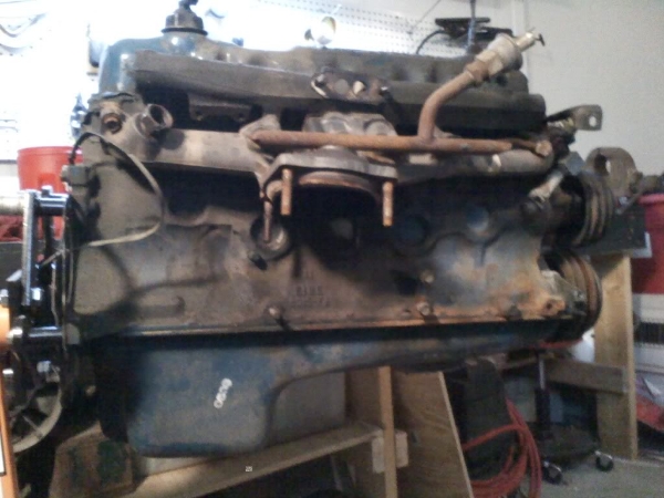

... wonderin' if anyone else ever considered adapting the odd Cat-Exh manifold for a turbo mount?.
hav e fun
U mean a "Y" there?
or...
