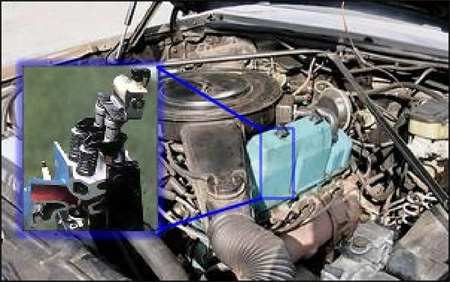

Cadillac's fix for Rough engine complaints was to install a switch in the glove box that killed the 6 cyl mode so thier 4-6-8 only ran in 4-8-8.

Cadillac simply used a solenoid to lift the fulcrum point on the lifter. The cam and rocker still operated as normal, but there was no valve action. If you used an eccentric on the rocker shaft you could rotate it to lift the rockers.

That is right, I had forgotten about it, but the Caddy 4-6-8 had these TALLL bulges on top of the valve covers over the cylinder that were deactivated.

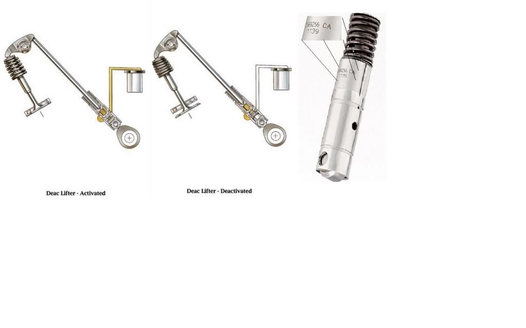

10 year old technology from GM's toggling V4 to V8 system does indeed eliminate the V6 cycle, and when applied to something light like a 6 liter Corvette, it saves a 16.7% cost in fuel at 65 mph if it could be equipped with with a special drone removing muffler. 35 US mpg verses 30 US mpg.
http://www.superchevy.com/technical/eng ... 5sc_gmdod/
GM 5300 "DOD" Displacement On Demand cylinder deactivation...General details and Patented Eaton roller lifter
I'd just like not to have to re-sleeve it down 1/32" to 0.8422" to suit the LZ8 or the 5.3L LH6 roller lifter above. Or have my cam grinder massage the existing HSO cam profile master to suit a roller cam.
Operationally, the LH6 always deactivates the same four cylinders in the firing order (1, 4, 6 and 7). According to Meaghan, lifter design and pushrod length are the same for all eight cylinders, but camshaft lobe profiles are different for the cylinders, which are deactivated. (This seems, in part, to contradict the GM media website, which states, "...in displacement-on-demand equipped engines, half of the cylinders have unique two-piece valve lifters..." -this being an important stipulation for those wanting to swap camshafts.)
For hot rodders wanting to modify their DOD-equipped LH6s, it's important to know that the switching lifter has a lift limitation of 15mm (at the valve). The factory cam uses 12.2mm of that (about .480 inch), giving the LH6 a theoretical valve lift limit of .590 inch. It's worth noting that this limit is for the lifter; a different valve spring would almost surely have to be used at this valve lift. Interestingly, it seems possible to grind a custom camshaft, which would only provide increased lift and duration to the non-DOD cylinders (2, 3, 5 and 8), thus allowing higher lift with standard non-switching lifters in those cylinders.
PHR would like to thank Tom Read of GM product communications for arranging the interview with Chris Meagher
Read more: http://www.superchevy.com/technical/eng ... z31vX7PzHE
and https://www.youtube.com/watch?v=T2MH01pLNX8
Why is it that Chevy parts are always the ones to use?

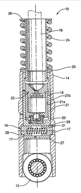

I guess the collapsible lifter above is the best option. BlQQdy Ch**y part number #2569256 CA 1139....0.842".
Eaton's HR-384 but with an external spring as in page 5 of 8 on the http://www.eaton.com/ecm/groups/public/ ... -guide.pdf catalog, but several US Patents such as US6802288 and US7308879.
http://i1215.photobucket.com/albums/cc5 ... 802288.jpg
http://www.google.com.lb/patents/US7308879
