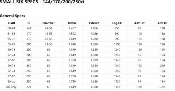

Thanks - Looks like I have the correct match. Specs sheet for for 66-67 head says C6DE. This matches the head casting code. Thanks again!Check your current head casting code you may have a later head as they tend to get swapped over the years:
Should have sent this first but as you can see the later heads had larger log volume and some had larger intake valves. Is better for a 2v carb conversion such as a small based Rochester which is a comparatively easier conversion than say the Autolite 2100. Direct mount, no adapter.Thanks - Looks like I have the correct match. Specs sheet for for 66-67 head says C6DE. This matches the head casting code. Thanks again!

why do the older 200 have more HP? is this accurate or the way it was measured?Should have sent this first but as you can see the later heads had larger log volume and some had larger intake valves. Is better for a 2v carb conversion such as a small based Rochester which is a comparatively easier conversion than say the Autolite 2100. Direct mount, no adapter.
Having said that if your head is rebuildable it could make a lot of sense to go that way especially if the Rochester swap is doable or a larger 1v. Doesn't sound like max performance is a goal for you.
It takes awhile to find heads these days you may want to start looking now.
The way it was measured and influenced by the marketing department at fomoco.why do the older 200 have more HP? is this accurate or the way it was measured?
