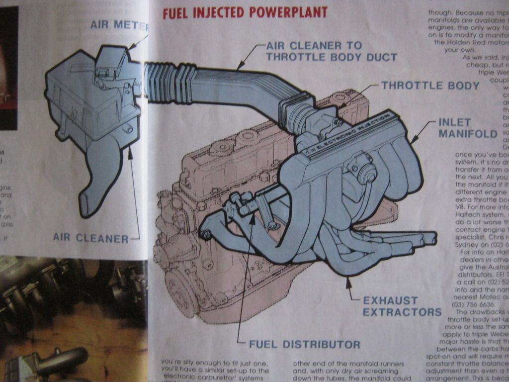

The second system was used on some aftermarket kits, never a standard I6 set-up that I'm aware of. A system similar, but not the same was the tri y Australian XT6 Holden Commodore Ei 6, used for a . It was a punny 142 hp, 198 lb-ft 3.3 liter engine which was stuck with the GM Strasborg 3 stage auto and 3.36:1 diff. It gave a 16.7 to 17.2 sec 1/4 mile depending on appiontments, and was faster than the 135 hp 4.2 liter V8 by 1.3 seconds because of the header, cam and EFI package. It gave stunning performance, a great engine not and was, in my opinion, the very best exhast ever used by GM on its 12 port engines. The exhast system looked like this.
When the odds and evens cylinders are matched, the engine note changes. A further split, and it flows even better, with a BMW M3 I-6 style engine note. The difference between the 85 3.3 Ei Holden and the 85 4.1 EFI Falcon X-flow was that the Holden engine had more urgency, a better rev range, and a crisp, Germanic, almost Cologne V6 style note which was alwas inspirational. The non tubing header single out Ford was latent and unresponsive, even with 20 more hp and 48 more lb-ft of torque.
