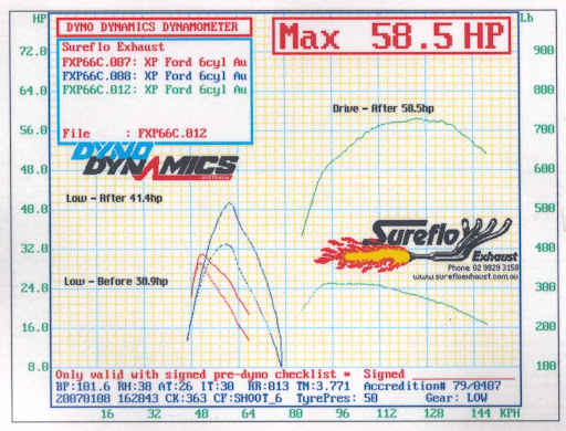

Anyhow I had the car before and after dynoed to test the gains (if any) of the swap. Unfortunately they only did the before in L (XP 3 speed autos only select Lock or Drive). Also they've shown the torque in Lb (I assume this is pound - force feet?) and the x axis in kph instead of rpm. They did do the after run in both L and D so I've got a better measure of the power at the bags (not much
) but can't give you a measure of what the improvement is.
In L the headers showed a 10.5 HP gain from 30.9HP to 41.4HP (thank god they didn't show it in KW!) which is a close to 33% as makes no odds. With the peak moving from 52kph to 60kph. Hmmmm sounds like an awful lot don't it? Torque went from 360lb to 415lb at essentially the same peaks. That's 15% torque gain. But again hmmmm. If it's pound force feet then thats 490Nm to 560Nm? Can someone explain these numbers? Is the fact it's being measured at the wheels giving a multiplication factor over the spec 156 foot-pounds (measured at the flywheel I assume).
The after run was repeated in D. This gave a peak HP of 58.5HP ! (should I get a special set of guard badges made up with that number on em?
) Unlike the runs in L the curve is pretty flat across the top with 56+ HP from 108-138kph (peak at 126kph). Really wish I had the pre header data to compare it to, but
