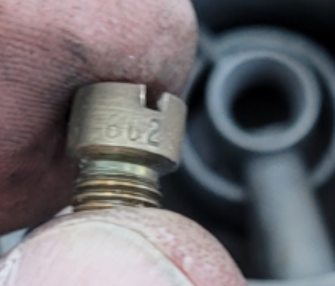

It has a 662 jet in it. Looks like a Holley jet but not sure, I did not compare to a standard Holley jet or try one when rebuilding it. Not sure what the suffix number is about but I believe it's approximately a 66 jet size.
Looking at the chart here (https://www.carburetor-blog.com/knowledge-base/1940-jets/) they list all these carbs as coming with a .068" which would be a Holley 67, regardless of application. Anyone know if these take a standard Holley jet? It looks like one but not sure if there may be a small size or thread difference. Don't want to pul lthe choke horn just to find it's a oddball type of jet I don't have. Anyone run a big 1940 on a smaller six and find a jet size that works well?
