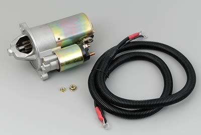

because i'm lazy to find out stock part numbers :lol: i'd thought i'd ask here. will a stock starter from a 302 / 289 with a C4 fit a 250 I6 with a C4?
reason for the question is i'm just thinking of using a ford motorsport mini starter for the 250 I6. i'm really happy with the same starter in my other cars but they are v8s and i thought it would be good for header clearance in the 250 I6.
anyways the part number
M11000A50 which is a 1.1 kw
or a
M11000-B50 which is a 1.6 kw
heres a link to the starter
http://store.summitracing.com/default.asp?target=partdetail.asp&part=FMS-M11000A50
any help would be great thanks in advance!
The small block starters work with the 250. The ones you have listed above should work fine with a 250, but the higher power one shouldn't be necessary unless you built a 12:1 monster.

thanks.. that helps! i hear yah about the 12:1 but i looking for the clearance more then anything. i can't see denting up the starter :wink: beside i like it when the car starts and it dosen't sound like your typical ford starter :lol:
