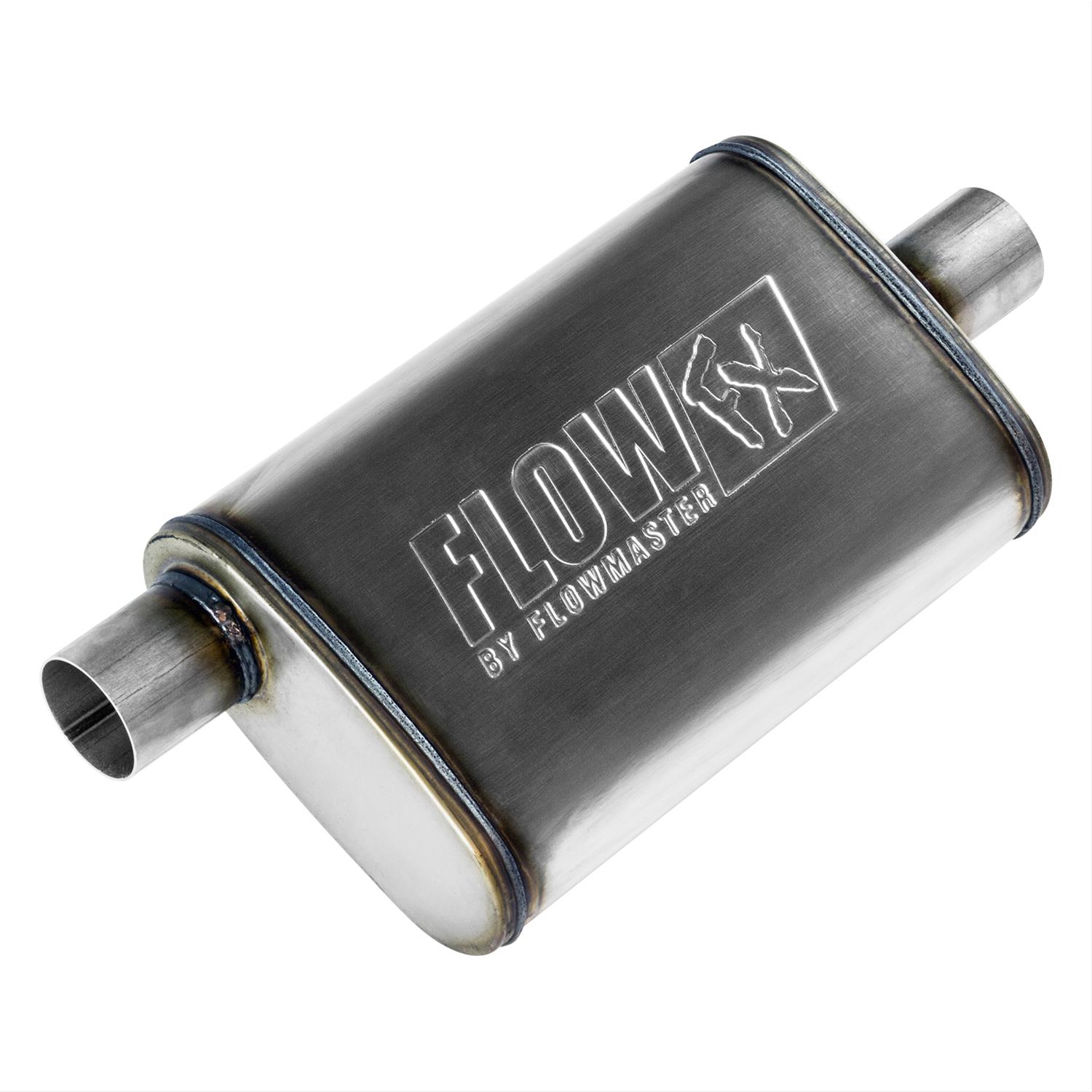

I bought a two-piece header from VI along with one of their 2.25" single pipe exhaust systems. The pipe runs out over the axle as you described but uses a single in/out. The muffler provided by VI sounded a bit too much like a tractor to my ears, so I used this one instead. I'm pretty happy with the sound. The muffler is positioned ahead of the axle.
I don't have pics of where I welded in the hangers, but I believe I put one forward of the axle just before the muffler and two aft of the axle.
