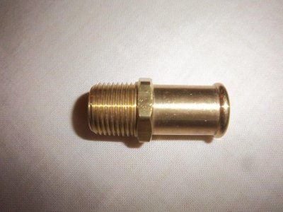

Was also thinking about not having a screw in fuel filter . As this area under the air filter housing is out of sight , so fuel drip had gone unnoticed for a long time . What do you think about installing a threaded fitting with a hose bead end , so rubber / flex fuel hose between solid fuel line to hose beaded fitting on carb .
Then installed an inline fuel filter some where , maybe even before the fuel pump . maybe mount some where if there is a fuel leak at the inline fuel filter connections it's not above something hot . Would be no risk of damaging threads at the carb and very easy to change out the inline fuel filter and less risk of fire . Maybe the threads are already damaged on my old original carb . Has anyone done this on a 200cid ? until i get this resolved , looks to me like hi risk of fire !

I do not like that idea, when you push the filter nipple into the hose pieces of hose can get peeled off and mess with the carb. Just fix the carb. fitting part.
