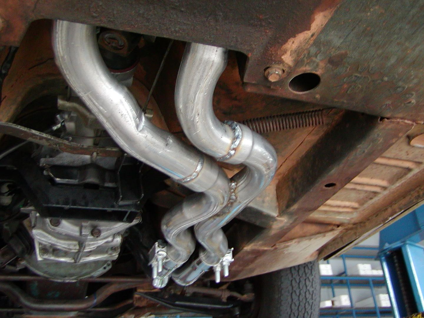

here goes nothing...first attempt at this posting thing...pardon the dirty underside of the car...need to have it steam cleaned!
Pipes routed above the plate and inside the transmisson/driveshaft tunnel
fabricated x-pipe..not as pretty as wsa111's setup, but due to the convertible steel plate, it needs to be fitted in a tighter space. Sound qaulity is terrific. NO DRONE!!

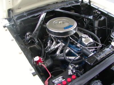

Picture of the engine bay showing the Pacemaker header...Jet Hot coated

It's in his second pic. Not really a "pipe" there, the two pipes just touch and are welded together. Like in Okefenokee's setup.
It is before the plate. Just cut a section from each pipe and weld the two together. To angle the X wider would only work if you decided to drop the X-pipe below the plate. I like having the pipes tucked up and it seems to work great.
