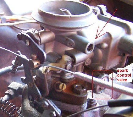

Your carb typically has a SCV and my bet is that it's blown- causing high vacuum and advance at idle and no power under load. Being it is in a truck may raise an exception, so the best, first step is to verify what carb (SCV or Non-SCV) type and distributor (LoM or Non-LoM) you have.

This is where your spark control valve should be:
I wish I could post a photo, but the carburetor I have on my '53 Ford 215 does not have a Spark Control Valve to the right and underneath the vacuum port. On mine, from the base of the carburetor - where it mounts to the intake - to underneath the fuel bowl there is no valve, just an open space???
