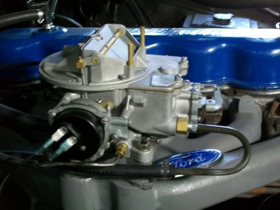

I'll be pulling the 1.02 Motorcraft 2100 carb off a truck soon. That's 243cfm. I want to try a 2150 M'craft I picked up. I have a AFR gauge, the carb runs rich in the transition circuit. that is, very light throttle. It's good everywhere else including cold start up, electric choke works perfect. Let me know if you'd like to have it. In excellent physical condition.
Great manners and plenty of power on a 240.
I wonder what kind of adapter plate I would need for that for my Clifford intake?
