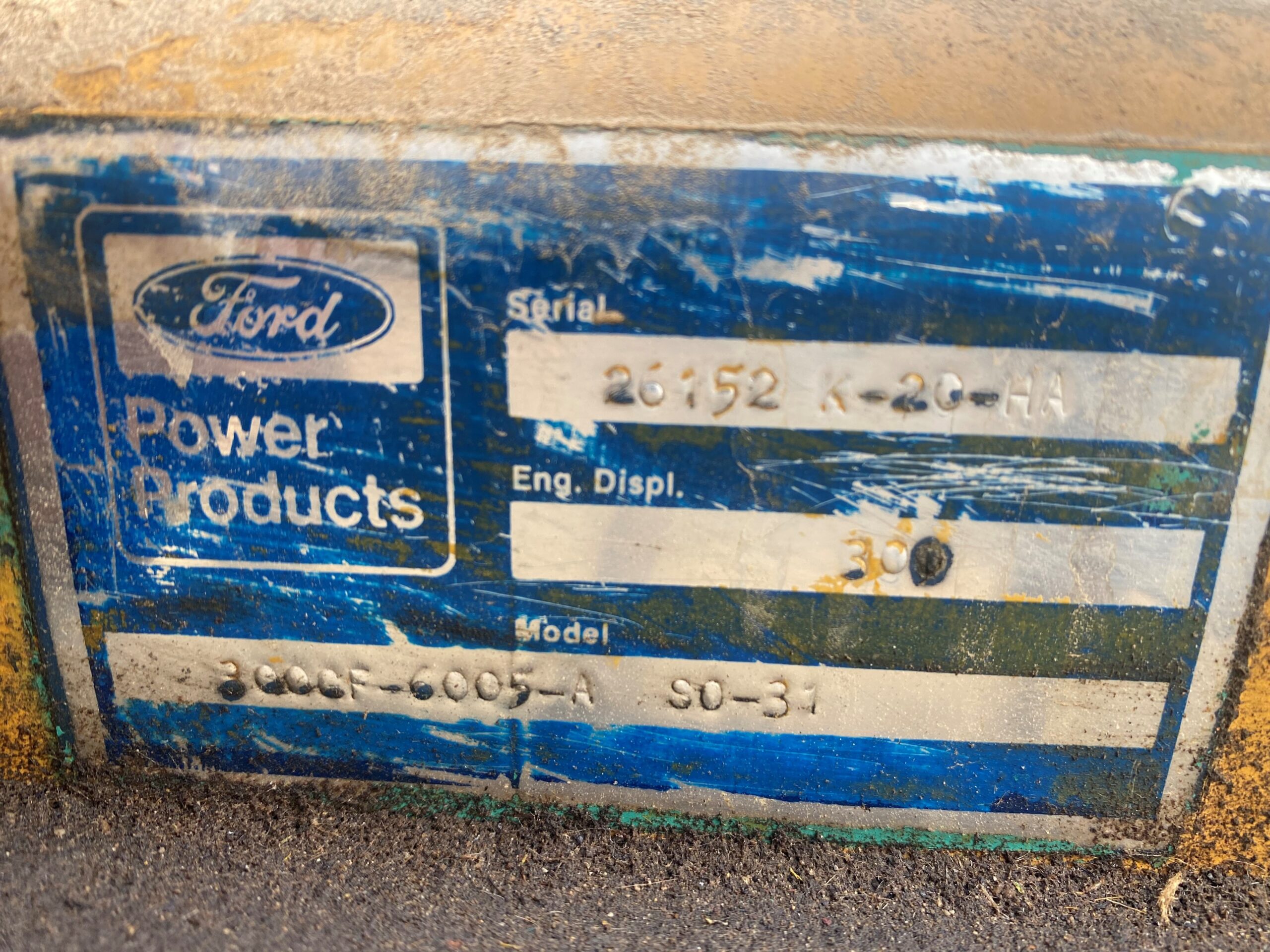

Hey guys. I have what I believe to be a Ford 300 cid engine but I can't seem to determine what year this thing is. I have a blue sticker on my valve cover that says the following:
Serial #: 26152 K-20-HA
Eng Displ. 300
Model 300GF-6005-A
Any idea on the vintage of this bad boy? Website with a good decoder?
This is a 300 industrial that is in an old Generator - not a truck or a vehicle.
Thanks for any info you can provide! Can post pic of sticker if necessary as well.
here is tag on valve cover I described
From the little bit I can find, they were used in Onan generators made in the early 70's. Perhaps you can look up the serial number of the generator and get an idea from there. Is it gasoline, propane, or natural gas? Is the ignition electronic, or does it have points?
Lou Manglass
Hey ksswaney- welcome. You want to look for the numbers cast in the block, it will reveal engine size and build date. They are on the right side (manifold side) near the rear. The first # give engine info, the date is the smaller number to the right after the bump that looks like a straight-head screw.

Lou,
Cant find much on this generator I have. It is a stamford generator - but funny thing... under the yellow industiral paint is the Onan Green. Appear to the 1 in the same. Hasn't helped me find the year of my Ford 300 though .....

The problem with the 300 is that it was produced over 4 different decades, 60's,70's,80's, and 90's, the FE's had a similar problem they were produced in the 50's,60's,and 70's, with the FE at the Dearborn foundry (DIF) they addressed this by casting 2 dots under the first digit of the casting date code to signify the second decade of production but I don't know if they did something like this with 240/300 blocks, you would need to use the casting number and casting date together to determine the year while hoping that a casting number wasn't used more than 9 years, example being if a C5TE casting number block were used thru the 75 model year.
Points means it's pre-1975. I have just removed a 300 from a truck, and it's not going back in. I have a NOS new nice fuel pump, the old style with the filter canister on top. Also the 1 barrel carb which ran good. Would like to see them be used, if you're interested in getting these send me a PM.
So the number next to the bellhousing starts off with D5T (not sure on third character) but looks like according to the link above
D = 1970 Decade
5 = year so 1975
T = Heavy truck engineering
Sound right?
Thx guys
It could be 1975, the points vs electronic isn't a hard and fast rule, for one it could have been swapped if the engine was swapped into an older truck and second the transition to Duraspark was kind of hit or miss some cars got them as early as 1974 while some rigs kept points, I think it was 76 or 77 before you could expect all rigs to have Duraspark.OK I just reread your earlier posts about this being an industrial engine, I think industrial engines were some of the last to transition to electronic ignition.
