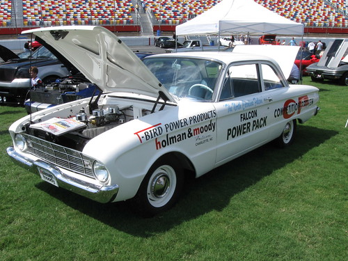

It could be the tri-power setup... not sure if HM made a tri-power or not. It could also be refering to the kit for the Paxton blower (not sure if that was HM that did that kit or not though). I found this image in a google search, not sure if the tri-power on this Falcon is made by HM, Offy, or Edelbrock. I don't know anything about this car but maybe someone else does....

I actually have the Y-block-in-a-Falcon issue, that's also from 1960 (May, I think). If I ever get a wagon, I may go that route (I'd like to tow a matching boat or camper). I have seen the Challenger before, but never really liked it. I *love* the H-M lettered Falcon, though. That would be a neat one to know more about.

According to the 1962 edition of Hot Rod magazines Hot rodding the Sport Compacts it talks about the Holman Moody upgrades and dyno tests. Holman Moody designed their own triple intake but never marketed.Basicly the intake kit was 2 extra carb stands that needed to be welded to the intake.With their cam kit which consisted of lightweight barrel lifters, tubular pushrods, single valvesprings with 98 pounds of pressure and steel spring retainers they were able to get the lil 144 to rev to 6,000 rpm, where it made 113 hp & 116 ft/lbs of torque at 4,000. Corrected for temperature, altitude and humidity H & M estimated the rating to be around 128 hp & 131 lbs of torque.
yep - i have that edition of hot rod ( march 1960) where they show the different ways that they upgraded the falcon- the holman moody one had welded on stubs and looks like a std exhaust manifold from the black n white photos in Hot rod

I still wonder about the '60 above. What do you suppose it is? Challenger 1/2?

I have also searched for info on the history of this car and the Holman Moody connection after seeing a pic from a FCA regional show in orlando fl.here is the link.you can see the Holman Moody CP tag above the master cylinder .http://1bad6t.com/suncoast/12regional/photo5.html
thanks for that - i looked on the web google search but didnt turn up those pics.
i assume thats the replica that lee holman referred to - thus the Holman moody CP plate isnt original (??????????)
good to see the interior - always wondered if it was bench or bucket seats and looks like it has a floor shifter

The H/M Falcon is a clone of the orig. Charles furr & Larry Miller of Midland NC did this car to H/M specs + a little. The orig crashed and burned if memory serves me right.The H/M power pack was cam,intake,carbs & header plus some undesclosed other mods. This car also has a 4 speed & i tink is a 200 six, with there again some unresclosed mods. I talked to Charles the other day and he was keeping some of the stuff that was done under his hat.

your memory serves you correctly
if you check my post above, lee holman said his brother crashed (flipped)the orig in about 1964
are you saying the orig was a 4 speed and 200ci? - or your friends recreation is the 4 speed and 200ci?
as my reading of the hot rod march 1960 article said its a 144ci
