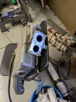

Can someone post up a pic of the plenum without the throttle body.

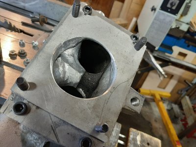

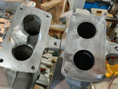

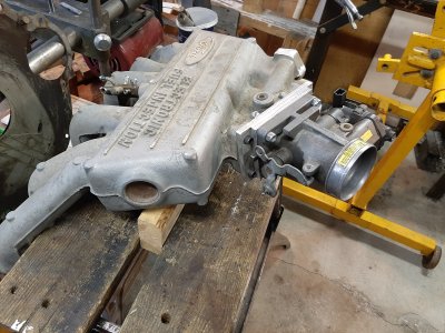

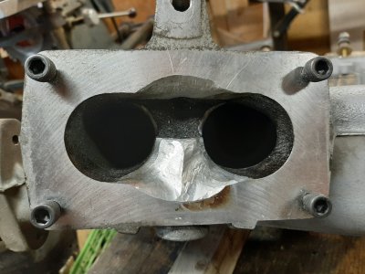

Adapt a single hole throttle body to the EFI intake. I used one off a 5.0 HO v8 from the junk yard. So the TPS and IAC should be compatible. The flow into the plenum does not look to be ideal, but that's where boost will compensate. I later made a better adapter plate out of a singe piece of 3/4" thick aluminum to replace the one shown made from two pieces of 3/8" plate.
