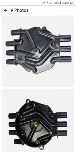

So yoy gotta buy another and cut it up to the the guts? I've seen those exact ones before but I don't think they fit our distributors
A cap adapter might be the way to get there.I would caution against the gm vortec style. They leak across..see where 2 leads are adjacent

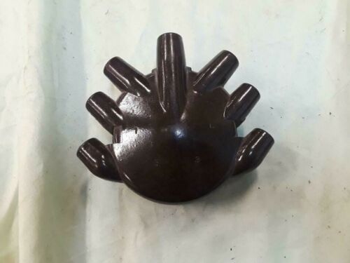

Actually that 1941 to 1947 Ford Six Crab Cap maybe kind of easy to fit onto a later Ford Six Distributor such as a 1968 to 1974 Point or the DuraSpark I since Ford kept the Distributor dimensions close to the same for many years. I was going to try using one on a 200 Six Cross Flow conversion.
If the crab style cap is larger than the distributor diameter, that would be very easy to design a 3d printed adapter ring for. Rotor button might take a creative solution.
