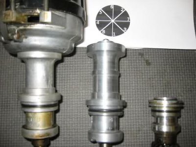

I assumed you figured something out for the pump drive. :cautious: If not, I've cut a number of Ford distributors down for distributorless pump drives, and installed tiny sensors reading a notch in the shaft for cycle ("cam") signal. Not difficult for lathe workers. If it needs to be really short (last on right), then a small roller bearing or full sleeve bushing is required to replace the (now missing) stock upper shaft bushing. Again, not a big deal. (y)

Hello everyone and thank you for your input, I'm working with a guy at Haltech to set this up since they are supplying my engine management system. The only way to have sequential firing is to read the cam by installing 3 magnets at 90 degrees apart, the only area on the cam gear solid enough to install the magnets is only available to read where the harmonic balancer crosses the timing cover. That leaves the distributor. I wasn't planning on running a distributor since I'm dry sumping the engine. I spoke with the owner of Aussiespeed last night and the two distributor gears available for a crossflow will not fit my distributor shaft. So, I need a short distributor which I will be taking to Haltech and my contact there is going to help me setup a wheel on it to read the sensor. I am very interested in the LOM that Rocklord is talking about and would appreciate any help on where I can locate one. Thank You

Ah, Haltech. That would be called a flying-magnet 4-1 cycle (cam-speed) pattern (4 targets, one missing). Other options are still valid, e.g., 3 magnets on the pump eccentric (now centered wheel). And you can skip magnets if you use a typical automotive back-biased sensor that reads ferrous metal teeth, holes, slots, etc, (LS, Chrysler, BMW, ATS617, many others). They have an internal back-side magnet that reads the magnetic field distortion as metal features pass by.
