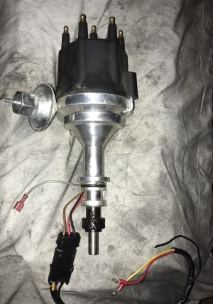

Added another distributor to the mystery list. It’s a billet electronic setup. The cap is held on by rotating lugs not screws. It has 4 wires coming out of it but the plug harness only has 3

I did find a number W0422 on the main body so I searched with that and it came up as a speedway distributor for a 289 but the one I have is for a 6 and the cap mounts different to the speedway distributor. This looks like the Holley version but with an extra white for the tach
The lug-locks would suggest a GM application, and the Chevy 6 rotates clockwise as well.
