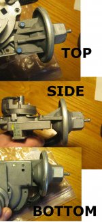

I've looked everywhere I can think of for an adjustable vacuum advance to fit the DuraSpark distributor for my 250. Haven't found one.
I know that vacuum advance units from the V8 Duraspark distributors don't fit.
Can anyone help please?

I have only seen replacements for the V8. It might be cheaper and easier just to buy a whole new distributor and swap them if your dizzy has been recurved.
This is a new distributor. I bought two remans from the local O'Reilly store. Both are the same and neither vacuum can is adjustable. I suppose I could buy a V8 distributor and see if I could swap the shaft from the I6 unit into it so I end up with the V8 advance but that's a lot of work with no assurance of success.

Are you positive that your's isn't adjustable? Is this a DS2 distributor? The cardone reman spec'd for a 1978 Fairmont 3.3 I bought for my 250 was. Try different allen wrench sizes, I think I've read 3/32 but I'm pretty sure mine was different size than that. You could also get one to the auto parts store and check it before you pay for it and take it home. STANDARD MOTOR PRODUCTS VC473
The VC473 is adjustable in the vacuum area only. The mechanical total is locked in. I know how to modify that. Each engine combo is different. Some require less, some more.
The distributors I bought are for the 75 Maverick with the 250 I6.
I went back and tried every Allen wrench I had and none of them engaged anything - until I forced the 1/8" wrench through the hole that was, up until then, too small to let it in. That engaged something inside that I can tighten and loosen. :banana: I guess I gave up too easily on previous tries when that wrench seemed too big for the hole - apparently a case of having boundless ignorance but applying insufficient brute force.
Kudos and many thanks to you Econoline! I owe you beer.:beer:
Show a photo of the chamber from the bottom side. The one i think you have is the large one. However it looks like one that i have that is adjustable on the vacuum side, but the total advance part on the one i have looks like it has over 20 degrees at full vacuum. It is an oddball. Cause i have over 20 stock ones which have a smaller diameter, but will not accept any allen wrench. I have thrown several of these large ones out because to adjust the total would not be worth it. The adjustable part of this can tops out just around 9" of vacuum at full adjustment counterclockwise.
