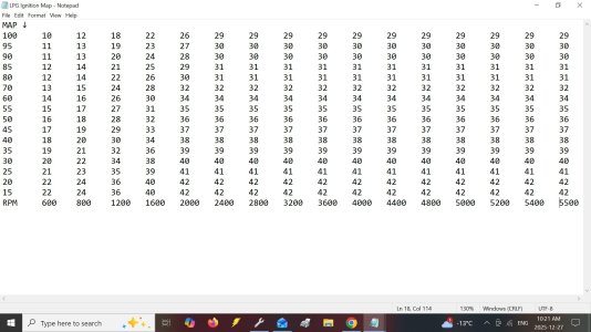

I need a base line ignition map for this engine configuration to use with Mega Squirt.
AI came up with an ignition Map based on these inputs:
4.9 2 valve pushrod inline 6 with ported head and flow enhanced stock size valves(1.78" intake and 1.6" exhaust diameters)
8.9 to 1 compression
Intake valve closes at 52 degrees after bottom dead center,
208 @ .050"lift intake duration 252 @.006" lift intake duration
211 @.050" exhaust duration 266 @.006" lift exhaust duration,
.525" and .516" intake and exhaust lift,
108 degree lobe separation and 104 intake centerline,
17" overall intake runner length with 1.65" inside diameter,
Short length well shaped tubular exhaust manifold with 1 5/8" exhaust runners 6 into 1 and 2 1/2 inch exhaust system with minimal bends.
460 cfm Propane carburetor with cold air intake.
