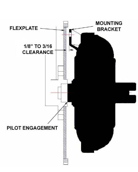

When I looked at the flexplate to torque converter, i was surprised to see a small gap between the two. The studs welded to the torque converter were engaged in the flexplate holes. I wish I could have gotten a feeler gauge or something in there to measure, would estimate it at about 0.150" - 0.200"? Is this normal? I put the nuts on the studs and slowly tightened them down as I rotated the engine to the 30 ft-lbs in the manual. There appeared to be clearance with the upper dust shield... I couldn't tell what was moving - was the flex plate flexing, or was the torque converter moving forward?

*Is it possible the nose of the torque converter somehow isn't aligned with the crank or flexplate ("pilot engagement") like the photo above)?
