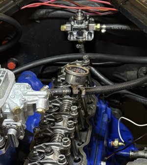

Fired up the car tonight. Fuel pressure is good - steady 2.5 psi now.

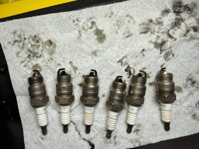

Removed spark plugs and checked cylinders - #6 had some gas again, so I cranked without ignition and fuel line disconnected to get everything out. I think because it sits slanted towards the back it just drains there.
Spark plugs got all dark (left to right from #1).

Glad to hear it. I’m assuming you’re now using an electric fuel pump?
I don’t understand why you have to crank the carb open like that to keep it going. My Weber 38/38 would be at redline if I held the carb half open out of gear. Clogged jets will cause that kind of trouble but your carb just arrived and I think you’ve gone through it to ensure it’s in good shape.
Your plugs should be tan or light tan.
