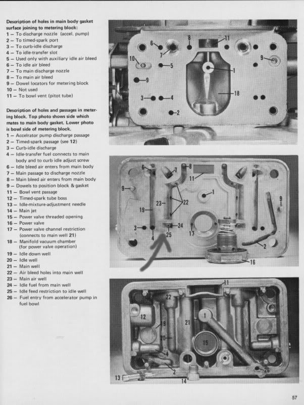

In the pic, #25 is the IFR in the metering block. The best way to enlarge these is to tap them with a 6-32 thread for removeable brass bleeds.
Same goes for the IAB's on top of the carb, they should be tapped w/ 10-32 threads.
