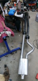

My 2 to one termination box a'la Vizard, a Summit brand " super Flow ". With the first baffel removed. A second inlet welded on. The volume to the next baffel is aprox. 5 litre, ( min 8 Times one cyl volume). Singel 2 1/2" out. Going to tune the colector lenghts on my Hooker headers and then connect them to the box.

Hum, just wondering wouldn't it be only 6 times one cylinder's volume for a Six engine?
Nice! The terminator box is something I'm going to do as well. BTW, Vizard says 8X because it's a V8 engine. For us, it's 6X for the minimum area.

NO, NO X-pipe. This setup is suposed to simulate equal lenght open exhaust. The moded muffler work like a termination box, on our six's the colector lenghts would end up around the same as the primary pipes, to 10" shorter. The paint burn of test would be best to determin the right lenght. MR Vizard has a good you tube video on the subjekt. " Zero loss exhaust" 👍
