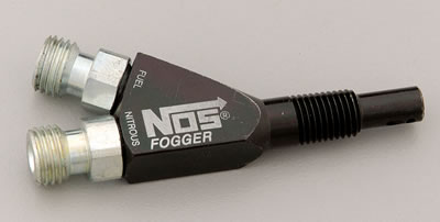

- Do these systems work only on EFI cars? The literature never says such, but I wonder how they could push out enough from the nozzle fuel jets with standard low pressure still feeding the carby. Thought it could be hard to balance consistently. Is this where regulated electric pumps are a good idea?
Thanks, Adam.
Are you talking about fogger nozzles?
If so, then the answer is YES, they are designed to work at or around 5-7 psi
I am going to tap into the EGR block off plate under the carby on mine and install one with 50 shot jets to help me get off of the line.
